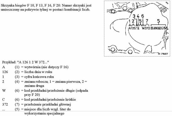

odnosnie samej skrzynni przytocze tu pewien cytat z http://www.migweb.co.uk/:
Quote:
the F code has nothing to do with the ratios or gearing its simply an identifier for the casing/box family, a bit like referring to an XE, ecotec and 8v as a "two litre"
vauxhall make 2 main gearsets across all of their older boxes Close and Wide, then they have a variety of final drive ratios available
it happens that ALL F20 boxes are fitted with the Close cluster, and either a 3.42/3.55/3.74 final drive
F18's are available in both close and wide and a wide range of final drives depending on application, a box from a sporty model will generally have a CR cluster where a boggo model like a 1.8 cavalier will most likely have a wide box
the codes should be printed on the box although im not sure where they are, theres an ident plate on the box somewhere and the ident is in the form "W394" where the letter represents wide or close and the number is the final drive ratio
tak wiec w tym wypadku wyniki beda roznily sie z powodu roznic w skrzyniach itp itd, a samo porownanie wydaje mi sie troche bez sensu zlosnik.gif

no tak dlatego napisalem Ci ze oznaczenie F16 o niczym nie swiadczy bo skrzynie te i tak mialy rozne przelozenia
a przedkosc na 2 przy odcieciu raczej nie powie o spadku mocy i tym podobnych problemach niewiem.gif
