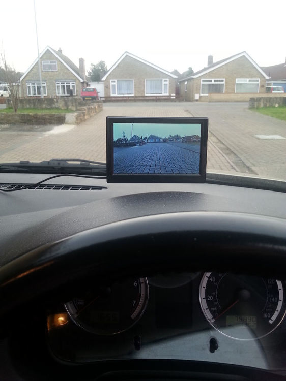

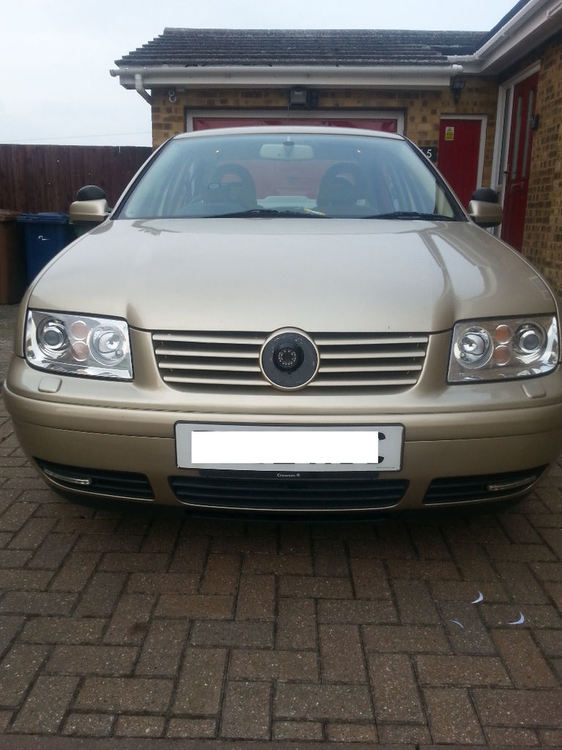

" Re, night vision for cars, for some time now I have considered doing this to my car, I have a VW Bora, with a large VW logo in the front grill, I removed this logo and in the circular space left I fitted a forward looking dome camera with a ring of infra red led's round the lens, then on the cars dashboard I fitted a seven inch led screen, the system is switched via the cars lighting system. I can tell you the system works really well, it cost less than £40 to buy, and when night driving on "dip" headlights the system can "see" further up the road better than I can, very pleased with the way it works and well worth the effort in trying it out as an experiment. "
