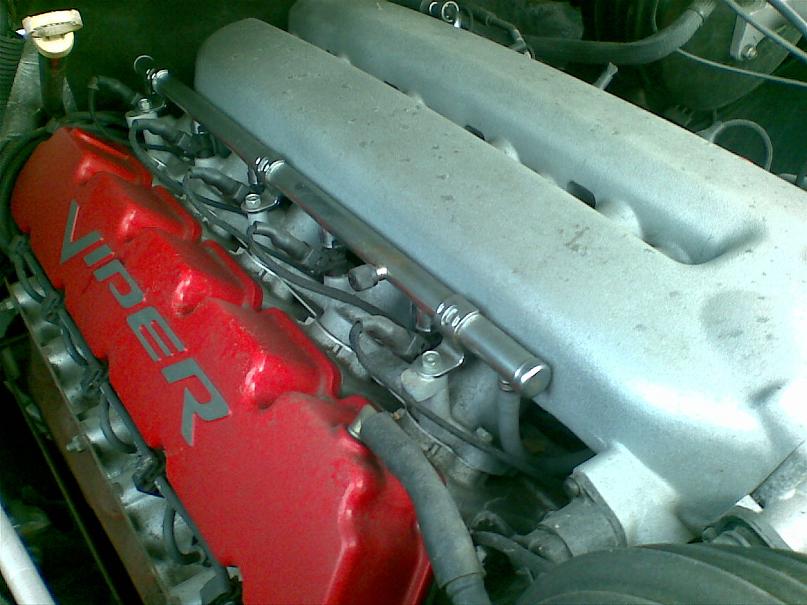

Z czego pochodzi silnik Vipera?
od czego wsadzili tam silnik?
Pytam o pierwszą generację.
Domyślam się, ze od jakiegoś "tracka" ale czy ori było to V10 benzynowe, czy blok był od diesla?
Za Wiki:
Quote:
The Viper V10 is based on the rest of the LA family, and appeared with the Dodge Viper in 1992. It was conceived and prototyped as a Magnum 5.9 with two extra cylinders and a longer stroke of 3.88 in (99 mm).
Originally designed as a truck engine[citation needed], Chrysler engineers revamped Dodge's cast-iron block V10 for the Viper[citation needed] by recasting the block and heads in aluminium alloy. Prototype blocks were cast by Lamborghini, at the time a Chrysler division. Some felt that the pushrod two-valve design, while adequate for the truck application for which the engine was originally created, was unsuitable for a performance car. However, Chrysler was uncertain about the Viper's production costs and sales potential[who?] and so declined to provide the budget for the modification[citation needed].
The first-generation Viper V10 engine has a displacement of 8.0 L (488 cu in) and produces 400 hp (298 kW) and 490 lb·ft (664 N·m).
W skrócie - został zaprojektowany jako silnik do trucka, ale Lamborghini, należące wówczas do Chryslera zaadaptowało go do Vipera, zmieniając blok i głowicę na aluminiową.
Silnik wkładali również do Dodge'a Ram SRT-10.
Dzięki.
Ale jeżeli tracka to miał być dieslem?

Znalazłem tylko
The rear face of the block had the same mounting configuration as the Cummins diesel engine with which it shares transmissions.

No i pierwotnie to była V8, do której na potrzeby Vipera dołożono dwa cylindry.
