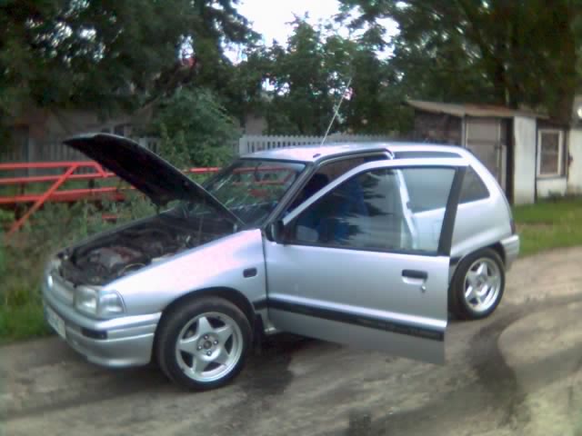

Znam doskonale. Ale to jest 3-cylindrowka w technice czterozaworowej.

-Radiator-the rad is an uprated unit meant for an Uno turbo, the coolant line has a T-connector installed to supply coolant to the turbo (the connector has a one way valve built in to prevent back-flow), after I removed the heating system the lines were run directly to the turbo, this was done for space reasons and obviously not to save weight!! This rad was an excellent choice and I would use it again, the engine has never overheated once since it was built.
-Blow-Off-Valve (BOV)-this is a stock Mazda MX6 BOV, it opens at around 7psi and is fairly quiet, this valve was converted to a recirculation valve since it did not make any cool sound no one missed it. Since I converted the valve shift times have improved.
-Adapter Plate-the turbo to manifold adapter plate was made out of 3/4" thick steel, with the custom manifold this was no longer used.
-Downpipe-this was made out of 2.5" stainless tubing to mate to the exhaust, I have since added a cat so a new downpipe was created without the O2 bung. I would use a cat has it allowed the modified engine to pass emissions with only 0.5%CO reading (3% is the max allowed for this engine).
-Exhaust-this is a custom 2.5" dual tip exhaust made by a friend, it is all stainless steel and makes a deep sound( not to loud when revved either), the backbox is a Remus unit with dual chromed tips. This exhaust sounds perfect and I wouldn't trade it for anything else.
-Charge Piping-all charge piping was taken from a Mazda MX6 and modified to fit using stainless piping. Custom piping would look nicer then this and be easier to install but it would cost a bit more.
-Fuel Pump-this is a Walbro (255LPH/45psi max) fuel pump, the pressure is set at 20psi, this pump was seen to be overrated for this task so an E2000 was used instead, anything that can flow 120LPH/20PSI can be used (stock mechanical pump flows 60LPH/0.3bar at 4000rpm)and is not enough. I would still use an electric pump but I've learned that the stock pump can be used if boost referenced (there is a port on the side but needs a nipple) for low boost applications.
-Fuel Pressure Gauge-this is a B&M gauge I had laying around, reads 0 to 50psi and is located under the hood (I'm making preparations to place it somewhere more visible during operation), it was actually removed once testing was complete
-Carburetor-this is the stock weber carb that has been rejected and sealed by my dads friend (make sure you replace the float if using high boost). It was intended to be replaced by an MPI system later on (I have since sold this engine and started another build), I have since been told and have confirmed that a stock carb in good condition will hold 20psi without leaks, the only sealing used was for the throttle shafts and float replacement. A stock carb can be used if it's rejected, another option is a carb for the Y10 turbo (Weber 30/32 dtml), Renault 5 turbo or you could use any other carb and box it (make sure it suits the engine). Multiple carbs are an option if used in a common pressure box. (problem with boxed carbs is the trouble caused while adjusting, they're in a sealed box!!)
-Cylinder Head-after blowing the headgasket the first time I had the head skimmed and port-matched, it also has a 4X4 cam installed so it has a little more grunt, the engine volumetric efficiency was increased from the stock 62% to about 74% with just the port matching, I debated whether or not to flow the head but decided it was good enough. A flowed head would have a much higher potential but would also rise the cost, another option is to use the head off a 1242cc 8V which flows much better and has bigger ports.
-Oil Cooler-this was an oil cooler I found at the scrappy (it was off a Volvo), I used it because the oil was getting a bit hot when running at the track, this oil cooler surpassed my expectations as the oil temperature dropped over 20C over a period of one hour of track time (this was tested by covering the cooler and then running again with the cooler uncovered). This cooler proved sufficient but any cooler can be used.
-Camshaft-this is the same one that is found in a Panda 4X4, another camshaft could be used to provide more low end torque and better flow at high revs (we were stuck as we could only adjust the timming, and it had to be retarded up top to prevent detonation). we eventually ran stock timming without any sign of detonation, but the water injection was always on standby.
-Fuel Pressure Regulator-this is a Mallory boost sensitive regulator (it adds 1lb of pressure for every 1psi of boost) another unit was originally used but could not compensate properly (the problem was traced to a clogged reference port on the intake), this unit is a bit expensive for what it does and could be replaced with much cheaper 1:1 units as long as they have a intake reference (aka boost reference)
-Boost Gauge-this is a cheap Autometer boost gauge. This should be included with any setup because it's one of the best ways to know the condition of the turbo.
-Air/Fuel Gauge-this is also an Autometer unit on a 3 gauge cluster, using a DYI-wb sensor, currently at 13:1 AFR. This is not required but makes it really easy to tune the carb (a CO meter is much cheaper and a good alternative specially if it can also measure nox)
-Transmission-The stock transmission can take 150hp for brief periods (you never drive at WOT all the time do you!!), the problem that caused my trannies to brake was wheel hop (once it was the differential, twice the tranny), replaced all bushings with urethane bushings and engine mounts and the problem is gone. I still don't know whether the Uno turbo tranny would fit as that would be a great option. I don't know how long the stock tranny can take 3 times it's normal power rating.
-Transmission oil cooler-An oil cooler and a scavenging pump was added to the tranny (using the purge and filler screws) to help cool the tranny in an attempt to increase life at the track. I would still use the tranny cooler as it helped keep the tranny much cooler and also increased fluid capacity to 5.5litres.
Do remember I'm not gaining anything by posting this , just so others may be interested in undertaking a similar project. If I missed anything please let me know either pm or email. I have now declared project Panda Turbo finished. (power was at 158whp/5200rpm on pump g100oct and 172whp/5250 on 110oct in February 2005 or point of sale)
When I sold the engine it had 3136km since the rebuild in Sept. 2004, those km were driven by friends of mine as I still don't have a Portuguese driver's license and my Canadian one won't allow me to have insurance on a car (I can drive insured cars but cannot insure my own!!)
This Project proved to be difficult to tune but demonstrated the possibilities that this engine is capable of.
> skoro zamieściłeś ten tekst, to teraz przetłumacz to...
auto to stary fiat panda, pierwotnie silnik 750
silnik zostałe zmieniony na 1.0 fire miał 80 tyś przebiegu
po klku dniach właściciel stwierdził że autko za wolne
no i wzmacnianie silnika zostało rozpoczęte od remontu czyli:
wymienione:
-wszystkie uszczelki
-panewki
-śruby "dołu" silnika
-pierścienie tłokowe
- głowica została "średnio" zportowana i spasowana z kolektorami/uszczelkami
- wałek z pandy 4x4
- coś zawory naprawiona (coated )
Częśck które zostały użyte do uturbiania:
- turbo ihi rhf3 ciśnienie 6psi(ok 0,4 bar) , potem troszkę większy garret gt15 ciśnienie 6psi(ok 0,6 bar)
- intercooler z mitsu stariona potem z talona (eclipsa)
- orurowanie 3 cale ze stali nierdzewnej
- stożek k&N
- w pozniejszych etapach inna uszczelka głowicy
- w pozniejszych etapach tłoki kute odprężające do 8,2 : 1
- w przypadku grubszej uszczelki pod głowicą potrzene było regulowane kółko rozrządu i pasek z 1.1
- kolektor wydechowy : na początku seria przerobiona, potem "customowy"
- sonda lambda - z myślą o pozniejszym wtrysku, a tak to do strojenia
- miska olejowa z zrobionym odpływem do turbo, kombinowali też z inną "niższą" coby wydech za nisko nie był
- chłodnica z uno turbo i podłączenie trójnikiem chłodzenia turbo
- bov z mazdy mx6
- wydech 2,5 cala z tłumikiem końcowym remus
- pompa paliwa walbro 255lhp
- wskaźnik ciśnienia paliwa B&M
- gaźnik - seria jedynie uszczelniony, głównie ośki przepustnicy i pływak wymieniony na pełny coby go ciśnienie paliwa nie zgniotło
- chłodnica oleju
- regulator ciśnienia paliwa ,[moj komentarz] w sumie cały "zonk" instalacji turbo na gaźniku, regulator ma utrzymywać stałe ciśnienia paliwa w stosunku do ciśnienia doładowania, ciś paliwa musi być zawsze większe od ciś doładowania o stałą wartość
No i to tyle z istotnych rzeczy
tak jak napisałem turbo na gaźniku to nic innego jakbyśmy jezdzili autem w środowisku gdzie mamy ciśnienie powietrza nie równe 1 bar, a np. 1,6 bar
warunkiem jest przystosowanie instalacji do wyższego ciśnienia paliwa (np. pełny pływak, uszczelnienie gaźnika), i utrzymanie stałej różnicy ciśnień paliwo/ciś doładowania
np. w normalnie paliwo ma ciś 0,08bara to przy ciś doładowania 0,6 bara ciś paliwa musi być 0,68 bara i ot cały zonk takiej instalacji
plus jeszcze oczywiście regulacja gaźnika - większe dysze itp...
