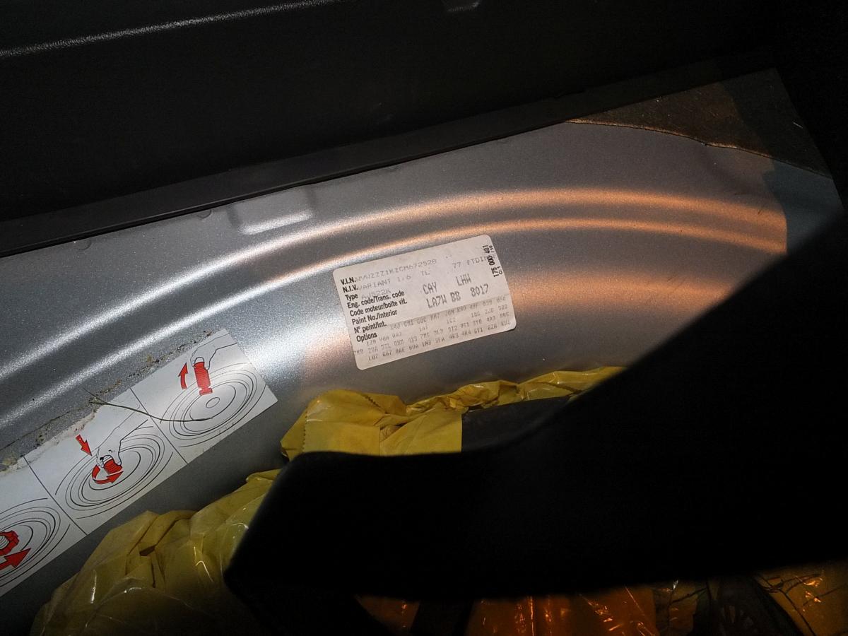

Wpisz sobie tu wszystkie kody z naklejki pooddzielane średnikami.
http://igorweb.org/equidec/Default.aspx
Dzięki wyszło tak:
X4J = National sales program Poland
CM1 = Steel wheels 6.5J x 16
G0C = 5-speed manual transmission
HH7 = Tires 205/55 R16 91V
J0M = Battery 360 A (80 Ah)
K8D = Station Wagon Variant/Avant
4VF = 1 2-point seat belt/3 static lap belts third row of seats in passenger compartment
D38 = 4-cyl. turbo dies. eng. 1.6 l/77 kW (4V)TDI common rail Base engine is TF3/TN1/TJ1
U5A = Instrument insert, km/h speedometer
1ZM = Disc brakes, front (Geomet D)
V0A = Tires w/o specification of tire brand
0A2 = 4 doors
1AT = Electronic stabilization program (ESP)
1G2 = Steel spare wheel with original equipment tires
1MC = Steering wheel (hollow rim)
2JB = Standard bumpers
5RQ = Right exterior mirror: convex
7K0 = Without tire pressure warning light
2UA = Standard design
5SL = Left exterior mirror: aspherical
0HM = Vehicle class differentiation -1KM- Build status corresponds to production in Mexico
4X3 = Side air bag front with curtain air bag
7MG = Emission standard EU5
3L3 = Manual height adjustment for front seats
3T2 = Three rear headrests
QG1 = Service interval prolongation
3YQ = Door pockets without insert mats
4A3 = Seat heater for front seats separately controlled
8BG = Twin-headlight for driving on the right,with integrated high beam
L07 = Suspension range 07 installation control only, no requirement forecast
G67 = Front shock absorption
8AE = Radio "RCD310 MP3"
B0A = Component parts set without country-specific design requirement
1N3 = Speed-related variable steering assist (Servotronic)
3FA = Without roof insert (standard roof)
4K3 = Radio remote controlled central locking operated from inside and safe securing
4R4 = Power windows with comfort operation andcircuit breaker
8Y1 = Two-tone horn
8ZH = Antenna for AM/FM reception, "diversity"
KH6 = Electronically controlled air conditioning system
