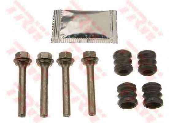

Znalazłem na ruskim forum taki mini manual
opis
Quote:
Next, we need to work: the key 14 and the key 17
1. Remove the wheel
2. Turn off the key 14, two bolt of the caliper
3. Raise and remove the caliper, it should be hung so as not to damage the brake pipe, or as I carefully put on
brake disc. But it is better to hang.
4. Remove the pads.
5. The key 17 unscrew two bolts of fastening of a support bracket to the steering knuckle. It is more convenient to use a larger ratchet head to remove the bracket 17..
6. I had soured lower guide. I squeezed in a vise clamp (main without fanaticism, so as not to burst) and key in the 17 developed the guide, then gently hammered into a power strip to ratchet tip guide.
7. Next, a wire brush and Vedeshkoy clear the bracket support, guides, clamps holding pads (I had them removed) protivoskripnuyu plate with the old pads.
8. Clean out the hole for the guide and remove the old anthers.
9. Install new anthers, smazyaem thinly guides and insert into the holes.
10. Next, I smeared the outside surface of the pad, brackets (holding block) protivoskripnuyu plate.
11. be careful not to smear the disc brake caliper bracket put into place, and fasten the bolts.
12. Put the pads
13. pushes the piston (I used a small board and montazhku) tormozuhi monitor the level in the tank, pump out too much
a syringe or a pear.
14. Put in place a support and fasten the rails.
The same conduct on the other side. I all took about 2.5 hours. With smoke breaks and interruptions to communication.

Co do smarów to było juz tu jakis tekst
Quote:
kupiłem polecany tu Plastilube, nałożyłem na starannie oczyszczone prowadnice i... zacisk przypomniał sobie, że hamowanie dwoma klockami jest skuteczniejsze niż jednym.
elektroda
Quote:
Prowadnice w zacisku hamulcowym na których "pracują" (przesuwają się) klocki hamulcowe smaruje się smarem miedziowym (może być w sprayu, ale znacznie lepiej sprawdzi się smar z tubki lub innego pojemnika gdyż jest znacznie bardziej gęsty i można go swobodniej aplikować).
Smar miedziowy nie wpływa negatywnie na jakość hamowania.
Inne smary niż miedziowy po zetknięciu się z powierzchnią roboczą tarczy/klocka są niebezpieczne, gdyż pogarszają jakość hamowania (w skrajnych przypadkach mogą doprowadzić do zeszklenia się klocków itp. przypadłości wymagających wymiany ich na nowe + dokładne czyszczenie tarczy ham.)
Dobry markowy, smar miedziowy w sprayu świetnie się sprawdza kiedy kupiliśmy jakieś marne klocki, które lubią popiskiwać wtedy wystarczy z umiarem popsikać po tarczy hamulcowej i problem piszczenia znika. (Uwaga! nie robić tego innymi rodzajami smarów!).
Natomiast jeśli chodzi o smarowanie tłoczków potocznie zwanych cylinderkami hamulcowymi polecam specjalne smary do tego przeznaczone.
Często smary takie dodawane są do kompletów naprawczych motocyklowych zacisków hamulcowych. Komplet taki składa się z gumowych uszczelek po których "slizga się" tłoczek i małego pojemniczka ze smarem (często mającym ciekawy np. różowy/czerwony kolor).
Ewentualnie warto się "szarpnąć" i kupić bardzo dobry smar do cylinderków hamulcowych Wurth'a ->

mowa o prowadnicach hamulca i smarze miedziowym, więc dołożę swoje 3 grosze. Też kiedyś wysmarowałem smarem miedziowym i było wszystko elegancko ale do czasu. Przy ujemnych temperaturach zaczęły się problemy. Gdy rozebrałem jarzmo zdziwiłem się, że prowadnica "stoi", miałem problem z ich wyjęciem. Problemem był właśnie rzeczony smar, wraz ze spadkiem temperatury zebrał się tuż pod samą gumką w górnej części prowadnicy, a w dolnej prowadnica z jarzmem pracowała na "sucho" Faktycznie był bardziej "gęsty" niż latem kiedy nakładałem go na prowadnice.
Ostatni raz użyłem go do tego celu, od tamtego czasu tylko i wyłącznie dedykowane to tego smary i pasty używam i problem nigdy więcej się nie powtórzył.
