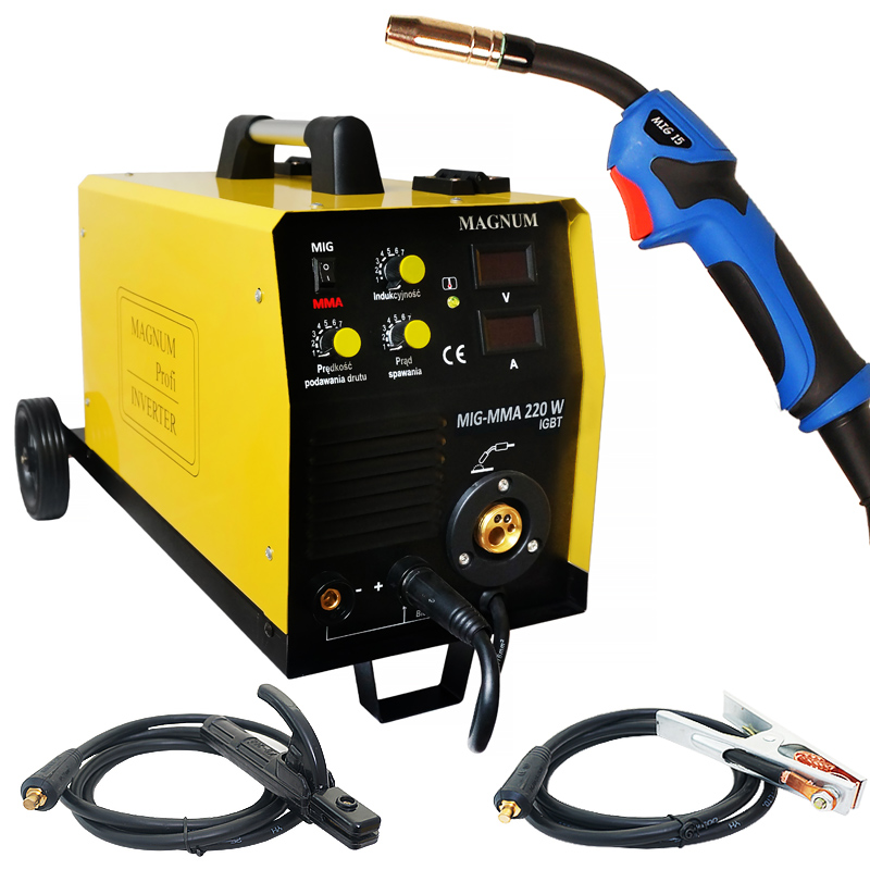

no to zostaje
Spawarka%20Magnum%20MIG%20220%20W%20IGBT
